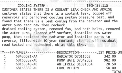

I had the radiator replaced under warranty, the water pump failed some test they give the water pump when replacing the radiator. The work was covered under warranty. I did see the parts and labor cost on the ticket.
Did you do it yourself? If yes, how long did it take, if no what did they charge you for the labor?
Pump was $982
Total labor for pump and radiator was $1943
100% warranty coverage so no cost to me other than the pain and suffering from them keeping the truck for 2 days.

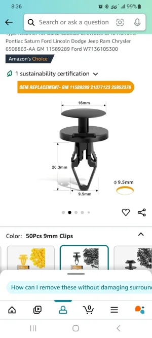

When it comes to the high prices: a single plastic push pin for the plastic over the radiator cost $13 EACH at the parts counter. I found the exact pin online with matching part number #6508863-AA for $7.99 for a 50 pack ($0.16 each). The mark-up is insane.

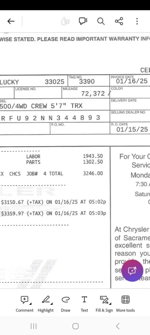

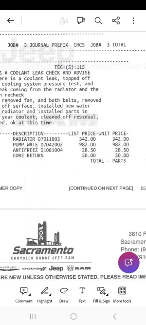

This is from my work order when they replaced the radiator and water pump. I didn't see any reference to removing the intake to replace the water pump. My definition of intake is whatever is on top of the motor between the heads. If your definition of intake is from the throttle body to the air filter, then that definitely needs to be removed.
