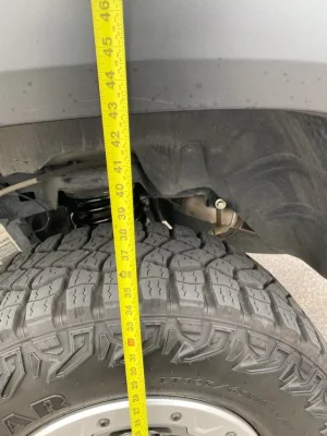

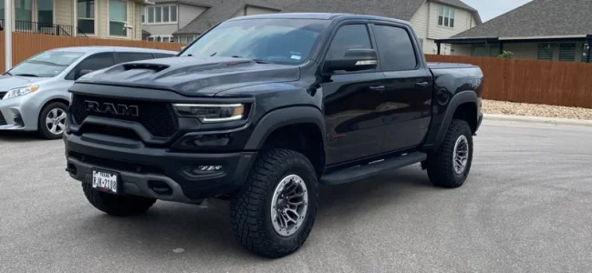

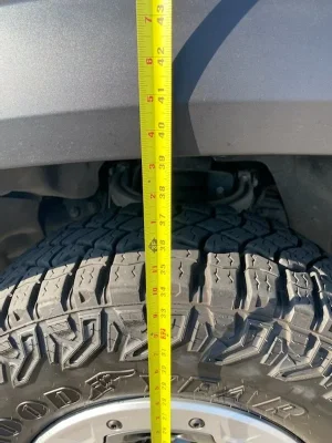

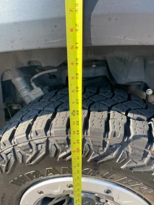

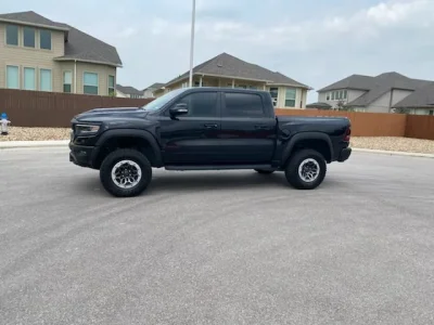

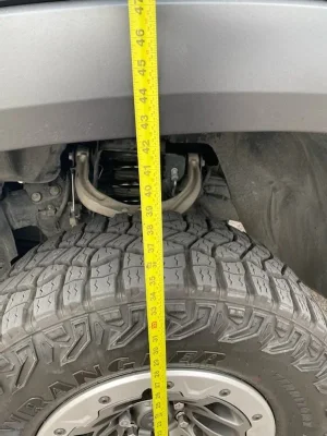

I got the four springs swapped out today and I'm impressed with the ride. Because of the progressive rate of the spring, the little bumps are much smoother. They're a little expensive for four springs but it seems like everything for the TRX is expensive. The front was actually easier than the rear. I had purchased a special strut removal socket (where it holds the strut still while you unscrew the bolt holding it). That made the difference along with the spring compressors I had from a previous build. I think the rear springs would have been easier if I had undone the lower shock bolt to completely drop the rear axel, but the spring compressors and a pry bar worked after a few tries. In the front the stock height (to the bottom of the fender) was 39.25" while the rear stock height was 41". After the Geiser lift springs the front sits at 42.5" and the rear sits at 42.75". I expect some settling but the truck looks great and feels smoother. I do have to get an alignment and take it to the dealer to have the ride height relearned / reprogrammed by a dealer only OBD tool.

That looks awesome. How does the truck sit from drivers side to passenger? Is it close to level?
That looks to be a really nice height!! It does make the wheels look a bit small which is crazy thinking of 35s looking small. I think it would look Sick sitting on some 37s!!!
