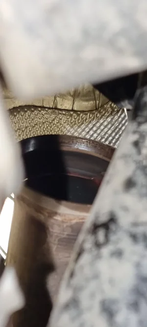

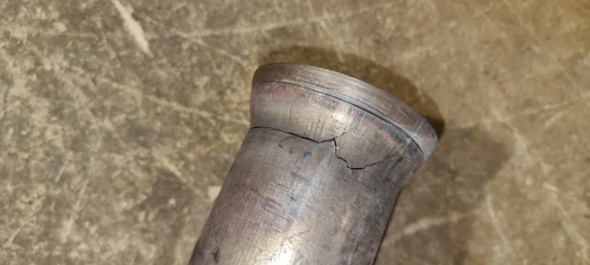

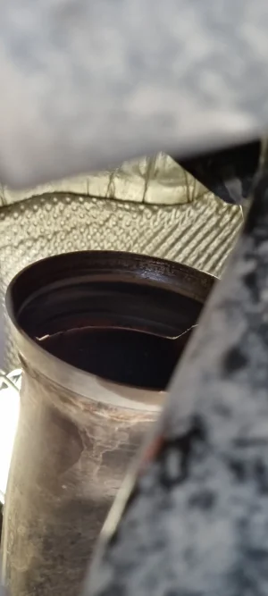

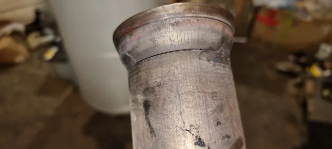

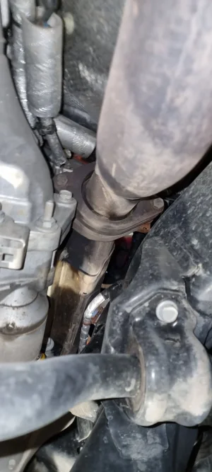

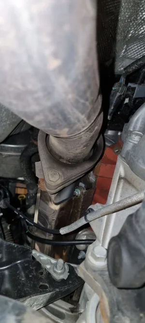

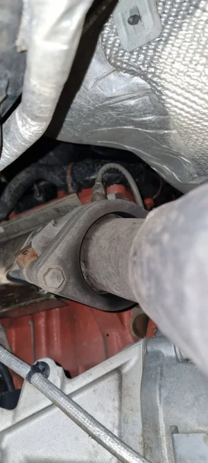

Привет всем, с Рождеством и Новым годом. Не так давно через 19000 т.км у меня появился неприятный звук при работающем двигателе, звук такой же, как на видео.
[MEDIA = youtube] tcyElqPSYco [/ MEDIA] После этого я начал исследовать машину и вот что я нашел ...

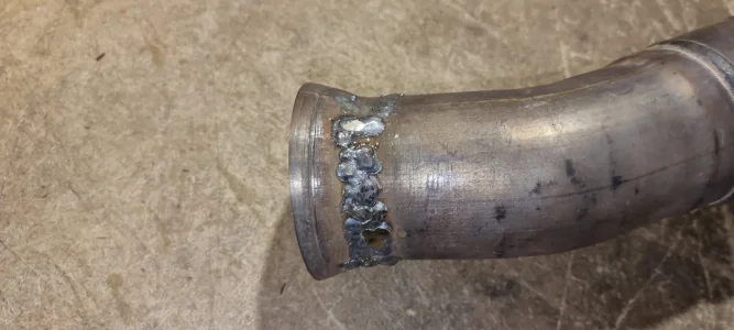

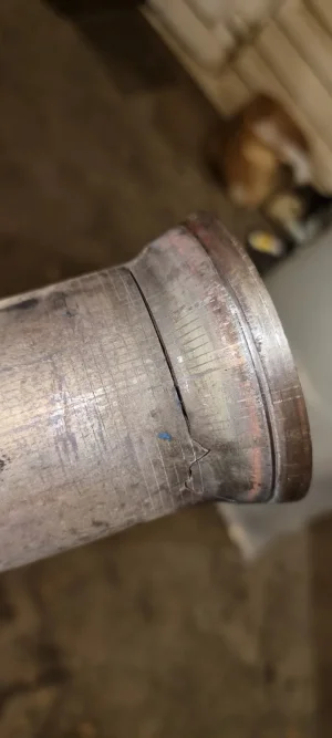

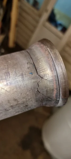

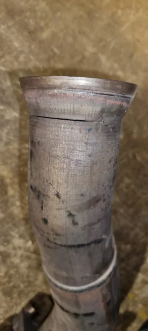

Это трещина на шейке выпускного коллектора, которая идет к катализатору, после разборки нашли трещину, в итоге пришлось прибегнуть к сварке, теперь абсолютная тишина, посторонних звуков нет.

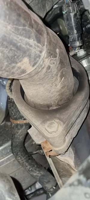

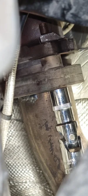

Иметь I am sure that this is a factory miscalculation, because if you look at the muffler, then from the engine to the very rear, it is not locked, there is a large load, as a result of which the neck cracks knee neck to catalyst. Therefore, if you have this kind of sound, check in places connections, having previously dismantled the bracket.I hope this will be useful for many, since I am in Russia I have to make repairs at my own expense without a guarantee, this is shit ...

Is this the squeak issue?
And if so is the problem/solution a crack in the cat pipe and the solution is just welding the crack?

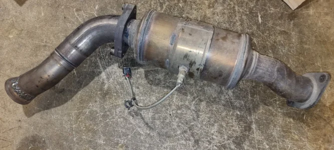

Yes, that's right. In my case, it was a crack that had to be welded, initially I thought it was a bad connection, but after dismantling pipes, it became clear.

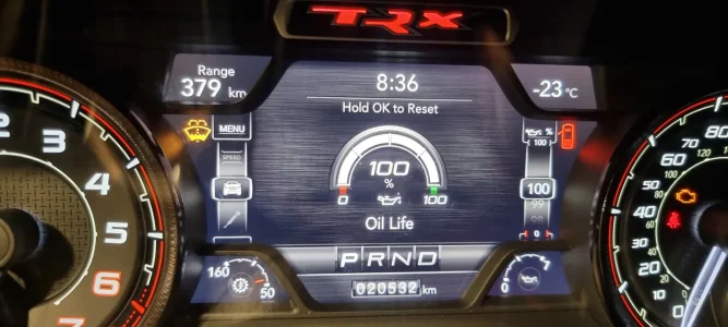

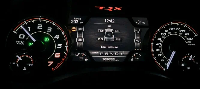

-23 C!! Crap...that's COLD!!!!!
Our winter is -23 and it's cold, from here the fuel consumption is reduced, this is the norm.
