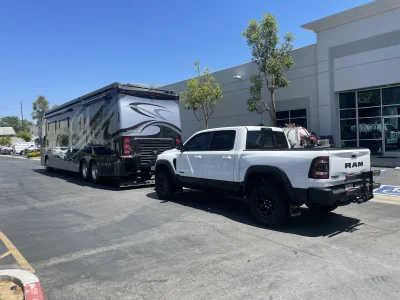

First test run today with the Entegra and TRX, drove it home from my building and it was no problem. Pretty easy to engage neutral. Took a few pics for @Durango

I was always curious does this add miles to your car?
