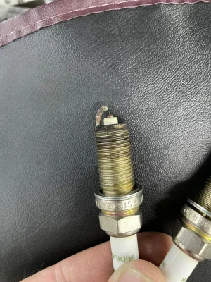

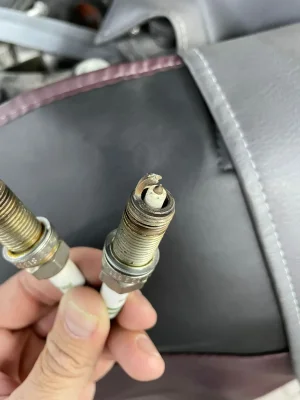

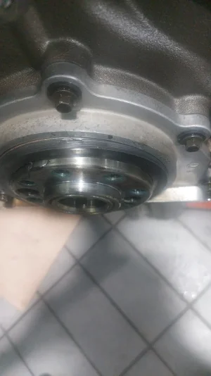

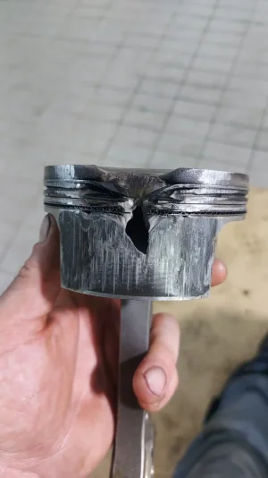

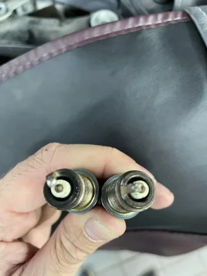

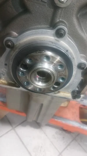

Sorry for the late response, had to do some running around with the truck. The engine was taken apart at the local service for vehicles in general, but the guys are good at their job. Now we have the pictures of the damage. Have a look. On the photos you can the 6th piston.
Maybe someone knows where I can get a repair kit for the engine? Tho it must be 0.5 - 1 mm bigger the than the standard kit if there's such option. And another question, is it possible get forged piston and side rod?

Ouch… Destination for sure, after it melted the crankcase pressure skyrocketed and pushed the rear main out from the looks of it. If you’re going through the process of rebuilding the engine I would also send off the injectors and have them flow tested. The injector might have gotten contaminants in it causing it to stick and lean out that cylinder.
I’m not super familiar with this engine platform but In the diesel world we would just sleeve the cylinder and keep it the stock bore. I’m not sure if that’s doable, but if it is you can pick up a piston and rod like P/N 53010927AD for a decent price.
Doubt there would be any warranty overage. Looks like a fuel quality issue resulting in severe detonation based on the condition of the spark plugs. The company I retired from sold equipment to Kazakhstan. They had a lot of issues with burnt valves and such not seen elsewhere. Turned out it was because of poor quality fuel.
