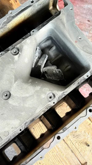

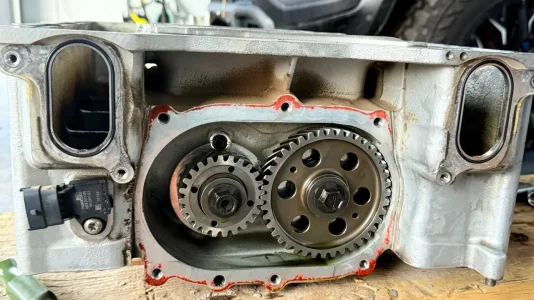

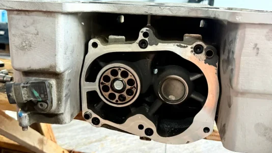

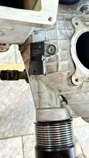

ПA couple of days ago a friend sent me this... He said there was no oil in the supercharger, as a result the supercharger left the chat... Has anyone serviced the supercharger, how much oil should I pour in and how do I change the oil in the engine?
The cover over those gears has two screws. Remove SC from truck, on the bench remove lower screw tilt SC and let drain. Use a hose and syringe to inject 6 ounces of oil back into the LOWER hole by tilting the SC back 45 degrees. It does use a special aviation grade oil and should last the life of the SC if it's not contaminated or no leaks develop. SC oil kit You can also rebuild the SC or send it to Kong and have them do it for you, which comes with new oil. Might as well get it ported while it's there. KONG PERFORMANCE
