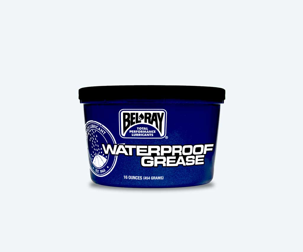

Have any of you dirt bike-types lubed the driveshaft splines with Bel-Ray Waterproof grease? I have a tub of it in the garage. A quick glance at the TDS and it seems to have better specs than the Liqui Moly grease. If I get the clunk, I think I'll give it a try.
