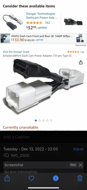

First of all thank you so much for this post. I really learnt a lot from it! I wanted to ask if Instead of buying the Constant power cable. Can we buy this cable in the attached file that gets the power from the rear view mirror. This way we can avoid the long cable also. Please enlighten me.

Just completed the installation, this can be done in 15-30 minutes depending on how meticulous you are. The excess power cable can be hidden in the plastic near the driver-side side panel near the door speaker. As for the running, the cable 95% of it can be hidden by running it in the gap between the windshield and headliner.
Once you get to the A-pillar just pull some of the trim back and run your cable behind it.
