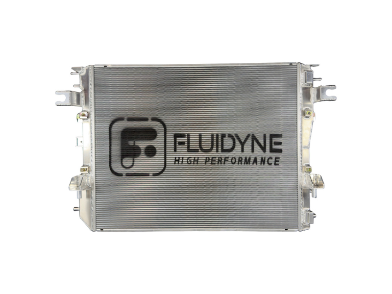

I put an order in for a Fluidyne radiator two weeks ago. I was told a 3-4 week wait. The owner, Frank, reached out immediately once I placed the order to let me know the wait times. I plan to post an update after the install and initial reviews.

Update: The radiator arrived after 5 weeks. It was a little behind their projected wait times, but still nothing to complain about. It was packaged very well, double-boxed with custom-cut foam to prevent movement. There was one bracket that was slightly bent and did not appear to have been caused by transport. It was easy enough to bend back to where it needs to be. New rubber isolation pads are included. I'll be going on vacation next week, so I'm hoping to complete the install sometime around mid-to-end-of April. I'll post a write-up on the installation process and provide a link when it's ready.

I finished installing the Fluidyne radiator. Overall, I'd say it was a 3/10 in terms of difficulty. What made it more challenging was the fact that I have an interchiller installed. The additional A/C and coolant lines made it harder to navigate the factory radiator out and the new radiator in. If you plan to do both a radiator and an interchiller, I highly recommend installing the radiator first. It may be possible to complete this install without removing the front grille, but I had to remove it due to the interchiller setup.

The Fluidyne comes with new rubber isolators for the bottom mounts. However, the top-mount rubber isolators on the factory radiator must be reused. Do NOT throw your old radiator away until you take them off. They are the ones that have a bolt going through them to mount the radiator to the upper support.
I found that unbolting the lower radiator mounts on the Fluidyne made it much easier to maneuver it into place. There was plenty of room to bolt them on after the radiator was positioned in the truck. Do NOT use power tools when tightening the bolts that come with the Fluidyne. I used my Milwaukee cordless wrench, which resulted in snapping one of the bolts to the lower bracket on the passenger side. I would have to take the radiator back out if I want to correct the issue. However, the rest of the bolts make it an incredibly snug fit, so I'm not concerned about it. I'll address it if I ever need to remove the radiator.

The factory radiator was leaking everywhere the plastic end caps met the aluminum radiator.
