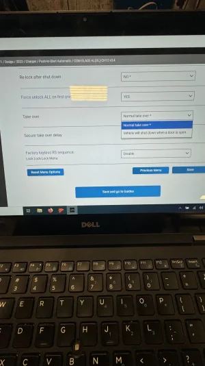

Let me see if I can answer it all, option table 2-16 if for all doors even drivers to shutdown. Same as factory remote start shutdown on almost all Japanese vehicles. Open the door it shuts off. To turn passive arming with rfid it would be 1-8-4, option table 3-1-3 will turn parking lights off while remote started or 3-1-1 will stay on and not flash. If the lights work then the correct resistor is installed so no worries. On IGLA turning extra options on will force shutdown if no pin is entered and you try to put into gear but only if start inhibit is on. If off it forces the autopark feature
Thanks. Option 1-8-4 successful. I cannot seem to disable door opening shutdown (2-16-1), although OP500 says successful/good.
That isn’t what that option is for. That is for actual takeover. Like a Toyota, even factory you open any door and remote start shuts off. Option 2-16 is so you can make a vehicle act the same way and will shut off even when the drivers door is opened. Changing it will do nothing. Software ch13 used on a trx is setup to do that, can’t stop it unless you open drivers door first from what I am finding out
I see that the Secure Takeover by Compustar should be set up to allow the driver's side door to be unlocked, opened, closed and foot on brake within stipulated timeframe to complete secure takeover. I see in other threads that the Compustar can be programmed to do that on TRX up through '23 (at least). If I could even get to that point I'd be happy. You say that option 13 will allow me to get to that point?
Ch13 is the trx firmware not the option. Its setup to work that way. Open drivers door, get in, close door, foot on brake for a couple seconds. All that has to be done before the takeover timer runs out, default is 45 seconds from unlock command. With IGLA its the same way and then enter pin to shift unless the additional blocking of standard immobilizer is on then you would unlock, get in, close door, enter pin, let it flash 2 times and then hold brake for about 2 seconds. If you open any other door before the drivers it will shutdown unfortunately and there isn’t a setting for it, its part of the ch13 firmware used on the ram/trx. I can talk to one of the compustar techs and see if it can be changed but those changes take a year or more to implement.
Wait...then perhaps my install wasn't flashed to the Ch13 firmware?
Truck locked via Compustar. Remote start via T13 or Drone app. Approach car and Proximity Unlock unlocks doors. Open ANY door (driver included) and truck shuts down.
I think the option you want isn’t changeable with op500. I am doing one on a hellcat charger in the morning, I will double check
Here is the setting that needs changed and has to be done by direct connection to it with weblink program and idata cable.
If you can find the brain you can change this setting yourself.
Menu 1 option 5
My dealer set mine up the same way to where if you remote start and open driver door the engine was turned off. Takeover was disabled. I went into the blade and changed it myself and now takeover works. Granted you have to pump the brake within a minute or two for the engine to keep running.
Menu 1 option 5
Need the cable and the weblink program to do that
You can do it without them on the CMX. I just followed the YouTube video that’s linked.
The option he is wanting to change is not a blade setting, I posted it above, you need the cable and weblink access to change what he wants
Thanks
Josh
@SRTIFIED, Thanks. I have the video. I have the weblink software, website access and datalink cables. I was really hopeful that I could change the setting via the antenna wire so that I didn't have to remove the truck instrument cluster to get access to the brains of the unit.
I figured it would be easier, quicker, and generally better to just have the original installer make the changes because he knows where the unit is and is willing to make the changes I would like..
