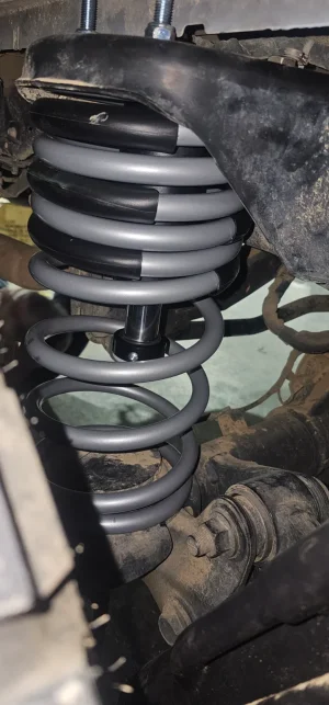

TLDR my question is weight releated, I have a very heavy load on the rear end,
Front Spacer
Rear Eibach HD spring + Spacer + Bags this gets me level with the front and just slightly over stock. I am very interested in this setup but again have questions about weight. Did we confirm that the Eibach Spring can be used with this?

Eibachs work perfectly. We just installed a set yesterday on the TRX heading to Sema. Oddly enough they install easier than factories thanks to the dual wind.
I have 3 customers running the Eibachs as well and no issues. The track bar ultimately is your limiting factor on down travel that direction.

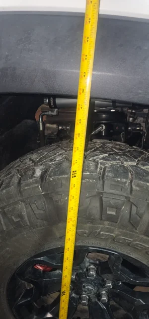

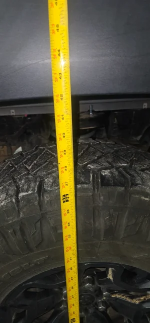

What is the overall ride height with these installed measured at the front and the rear with the Eibach HD springs?
Measurement from the ground to fender on a 37" tires at 40 PSI
