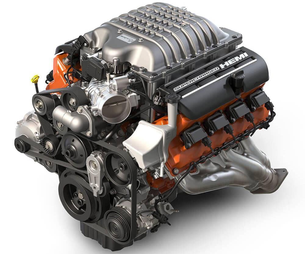

6.2 HEMI® V8 – Engine Specifications – Hellcat & Demon​
To get a better idea of what makes the 6.2 HEMI® V8 special, we have to dive into the 6.2 HEMI specs and how it differs. Although both models use twin-screw superchargers, there are variances.
Here are the 6.2 HEMI specs:
Manufacturing PlantSaltillo Engine Plant, Ramos Arizpe, Coahuila, Mexico
Years of Production2015 to present
VehiclesDodge Challenger SRT Hellcat, Dodge Charger SRT Hellcat, Jeep Grand Cherokee Trackhawk, Dodge Durango SRT Hellcat, Ram 1500 Rebel TRX Concept, Ram 1500 TRX, Dodge Challenger SRT Demon
Engine TypeFour-stroke, naturally aspirated
ConfigurationV-engine
Number of Cylinders8
Valves Per Cylinder2
Valvetrain LayoutOverhead valve (OHV) 2V
Displacement (in cc)376.3 cu in
Power (in hp)707 – 840 hp
Torque (in lb-ft)656 – 770 ft-lb
Max RPM6500
Compression Ratio9:5:1
Bore103.9 mm (4.09 in)
Stroke94.6 mm (3.72 in)
Firing Order1-8-4-3-6-5-7-2
Engine Weight227 – 312.9 kg (500 – 690 lbs) (dry weight)
Cylinder Block MaterialCast Iron
Cylinder Head MaterialAluminum Alloy 356
Exhaust Manifold MaterialFabricated Tubular
Intake Manifold MaterialAluminum Fixed runner length / Composite, Variable runner length
Oil Sump MaterialAluminum / Steel
Fuel TypeGasoline – racing fuel
Fuel Injection SystemSupercharged PFI
Engine Oil WeightSynthetic 0W-40
Oil Capacity6.6 L (7.0 qt)
Oil Change Interval5,000 – 6,000 miles / 6 months
6.2 HEMI V8 Engine
6.2 HEMI V8 Engine
Copyright: York Chrysler Dodge Jeep Ram FIAT
