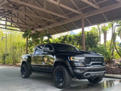

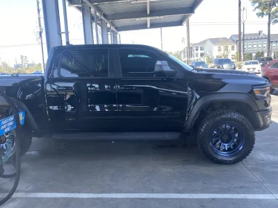

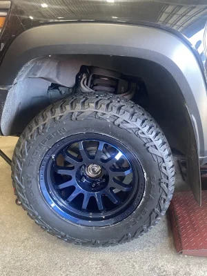

My budget build version of volk blue wheels, on 35’s:

@OP did you have any issues with wheel weights hitting your calipers on the TE37XTs? Did you also have to use a large amount of wheel weights to balance them?
My uncle runs one of the 4 wheel parts close by and he test fit everything and inspected the wheels before installing. He did mention repositioning the wheel weights so they wouldn’t hit the caliper as it is a tight fit. He also did the road force balance on them.
I haven’t had any issues, I’ll see if I can snap some pictures.
With the stock wheels being 18x9 19 offset and Volk offering 18x9 15 offset. Why did you go with 0 offset?
Same question from me.. Looks like a 0 offset is pushing outward 0.75". Do you think there is a clearance issue with a 15 offset which is only pushing outwards 0.16"?
When I picked up the wheels I went with the 0 offset as they would stick out a bit more over the +15 offset. The clearance is pretty tight with the 0, not sure about the +15.
Do you get any rubbing at all with 0 offset and (what looks like) the factory 35" tires? I am also looking at getting these wheels in black and not sure whether I should order the 0 or the +15.
Thanks!
Thanks!
No rubbing at all, still using the stock tires as I wasn’t wanting to go 37’s and lose any kind of performance, or use tires not rated for what the TRX is. Plus the light weight of the wheels is definitely a plus.
Great, exactly what I was looking to hear. Thanks!

I didn’t use hubcentric rings and haven’t had any issues at all.
Center cap just pops in from the back and spins freely until it’s pressed against the hub. Took me a bit cause my OCD wanted the cap centered to the letters on the wheels LOL!
Just make sure when you get the wheels on that they don’t use the sticky weights on the inside barrels because it’ll make contact with the calipers. You’ll need the clip on weights.
The weight savings is crazy when you pick up an OEM wheel and then a TE to compare.
