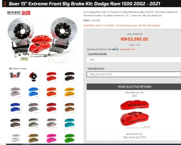

Pretty slim pickings on options or brands.
Do you know the size of the options so I can see what wheels they clear? I don’t want to go bigger that 20” if possible.
also while I haven’t done a brake torture test, the stock brakes are better than expected.
Looks like the wilwood has no chance of fitting inside a 20”

see attached Baer fitment pdf's
Anyone with 20’s willing to measure with the template and confirm fitment? If so please post the wheel used
