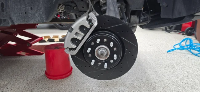

Installing these today! There is not much wear on the stock pads and rotors after 50k miles.
These god damn 13/16 bolts holding the calipers on have loctite on them and you need 100ftlbs of force to turn the fuckers almost the whole way out! I only had to hammer one rotor off so far.
Rouge Offroad what's the bed in process for the pads and rotors?
These god damn 21mm bolts holding the calipers on have loctite on them and you need 100ftlbs of force to turn the fuckers almost the whole way out! I only had to hammer one rotor off so far.
Apply some heat to those bolts and they'll back right out.
