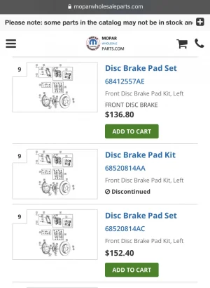

Are our brakes identical to a regular 1500? Thinking a good brake pad compound would work well something like carbotech for example
I tried to cross reference front rotor part numbers,
P/N: 68237063AB
2019-2020 all 1500 trucks
Big Horn, Laramie, Limited, Limited Longhorn, Lone Star, Rebel, Tradesman, TRX
P/N: 68368450AA
P/N: 68437269AA
2022 Jeep Grand Wagoneer 6.4, 5.7
One would think the first (2) AB and AA are left & right side but the 3rd. one is it listed once.
When I get a minute I’m going to visit the dealer myself and ask about it.
If you look up the caliper it’s a similar scenario with multiple part numbers.
P/N: 68237063AB
P/N: 68368450AA
P/N: 68437269AA
When I get a minute I’m going to visit thwdealer myself and ask about it.
