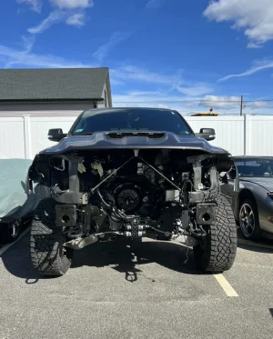

Sitting pretty, waiting for a heart transplant
Medevac chopper is in route with a new heart in a cooler of ice (aka new engine, on a truck, in a crate)!
