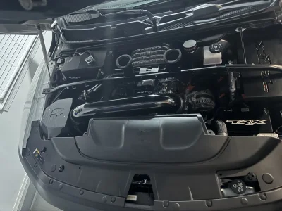

I chose the cornerstone because I can now see that beautiful hellcat engine, it increases the whine substantially but also uses the stock hood vents. The Atak and cornerstone complement each other well. Whine and crack of the exhaust, doesn’t get any better. Check out the different intake options (top engine- s&b, afe, k&n or side mount- Cornerstone, j&b, bwoody etc), we have plenty to choose from. Top engine will provide more whine (can take off the glass window of these intakes for some more whine) but won’t be as much whine as the side mount intakes.

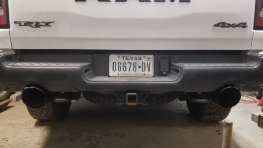

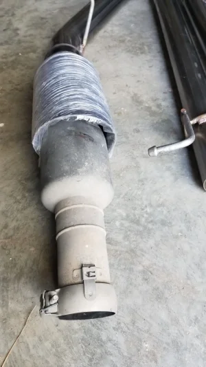

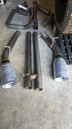

Aesthetics: Borla
The AWE 5" black tips are not deep enough, they are too short. When driving behind the AWE/TRX your eyes see the silver 3" pipe inside of the 5" black tips. This is really noticeable at night with headlights, looks like a rebel exhaust from behind (AWE pro tip, buy chrome tips so the 3" metal pipes blend in better, the 3" pipe will still be visible however).
The AFE tips are 6 inch diameter and are deep. The stock tips actually fit inside

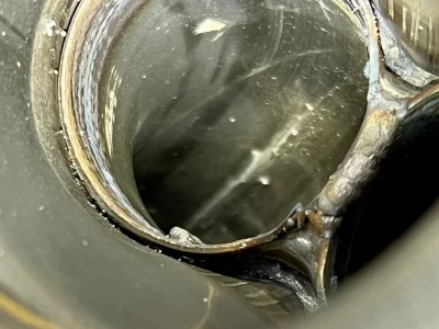

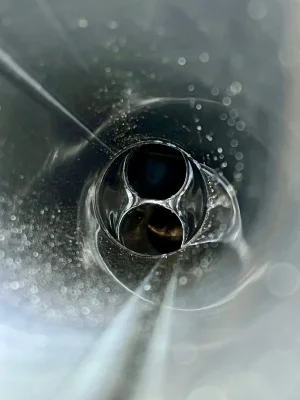

However, I have one concern:
The Borla ATAK uses four 2-inch tubes for the crossover + pass-through, which collectively provides less airflow than the two 3-inch tubes used in the stock's x-pipe. I think this could potentially create a bottleneck. I couldn't find any dyno data and Borla's customer service did not respond to my email asking for performance data on this system.
Take a look at the collector; the two tubes appear too small, and the quality of the welded transitions is disappointing.
