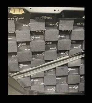

Here are some pics of when sound deadening material was applied to my TRX full interior rear wall, firewall, floor & all doors.
I'm running straight pipes and can hold a conversation without raising my voice or straining to hear someone talk.

Did the deadening inside the doors help the doors sound less "hollow" when closing them?
I did my doors, back wall and some of the floor. It makes a huge difference. But the main issue with the back wall are those vents. They are just thin slats of rubber open to daylight on the other side. While I was doing the work I drove without the back panel or seats, and they were open most of the time. Let a ton of noise in. I did some deadening on the carpet panel that goes in front of them but no matter what there is a slot in the panel that is open to the vents. Thinking about getting some acoustic foam and giving that a shot. They are necessary and I want them to breathe but not be so noisy.
Yes. There is only a thin strip of dampening from the factory and it seems like cheap junk. Even if you just go through the speaker hole and do everything you can reach, you will get a solid thud and better midbass without adding a ton of weight. Don’t need complete coverage to just dampen the panel.

No 3 pictures is shown some tile in the Door what is this name and where you grt this ?
Please let me know ?
