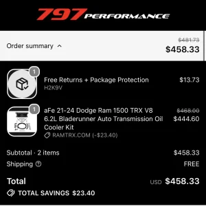

Just ordered one from @Nick797 . Will keep everyone updated.
Running heavy Nitto ridge grapplers 37, couple pulls, city driving I managed to reached 192. That’s with the 165 degree thermostat. Yes better compared to stock. But would like to keep it between 165-175. If possible. I’ll do a before and after.
