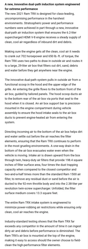

Just how they direct airflow into the box in a way that let's some larger particles settle out before drawing through the filters, how it deals with water, filter surface area, supposed lack of performance degradation over time, and obviously how it's 4x better than a raptor lol. Also thanks on the dry vs oiled
Here's a clip from one of their media releases:

AFE and S&B kept all these features but improved them.
