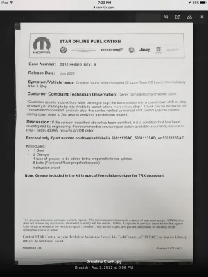

If I’m not mistaken, the driveshaft gets replaced in the latest revision.
Where did you hear that? The TSB says the same thing as the Star bulletin - boot kit and grease.
Someone posted a service bulletin on one of the FB groups. I didn’t save the image but I’ll try to find it again.
Here is the full bulletin
Thank you for posting this I showed this to my dealer today and it made everything super easy they checked my drive-line numbers to verify they match the service bulletin and that was it they are going to order the service kit for me and call me when it comes in.
I had taken my truck in to be checked out last year because I was worried about the bump when taking off, and there was no fix then but my file was noted so there was no need to reinspect they read the service bulletin and that was it.
