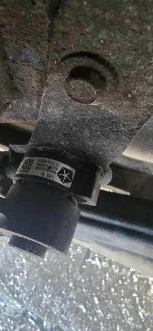

Hello.

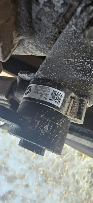

I replaced my broken sensor with another, used one, from ram but with air suspension, and it doesn't work.
Should I install a sensor specifically for trx.
Photo for info.
Please need help

Not to sound like an ass, but yeah the correct part number is probably what you need.
That or at minimum it could need a recalibration.

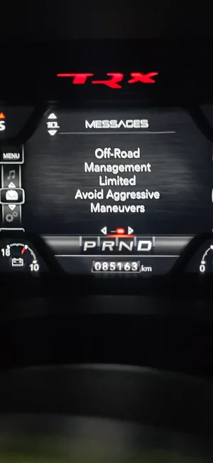

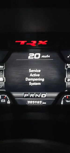

I get such an error, I am attaching a screenshot, but when we connect diagnostics through Launch diagnostics, it does not show us any error, and it is not clear where to look for the problem, there is no function to calibrate the sensor.
Maybe you can advise on what duagnostic to do this.

Need to connect to the dampening control module (ADCM) and check for codes there. Guessing it’s going to have a code for sensor out of range. And guessing that regular 1500 air suspension sensor isn’t going to work. No point in attempting a calibration until you check codes though.
05035652aa trx code
68277079ac
These two part codes are the same sensors that google shows fit the trx, so as I understand it, the sensor I built with a different code than the original trx sensor should fit.
What do you think?

Mopar parts catalogs at the consumer level are terrible as far as non-TRX parts being listed for TRX. They just lump everything together at times. Nevertheless, the one you installed is listed specifically for air suspension (#4) and 05035652AA is listed for TRX adaptive dampening (#5).

We installed the sensor today, which should be according to the code trx, the computer sees the sensor, but it only shows 0.25 volts, while the others show +- 2.5 volts.
What do you think could be the problem?
