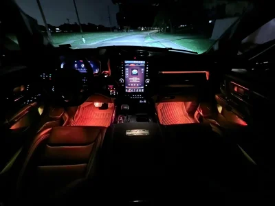

I finally got around to completing the ambient lighting kit from Oracle. The install wasn’t too terrible, but there were some difficult parts like the door rubber grommet wire routing.
Overall I think it adds a nice touch. I can adjust brightness and it has most features found with Bluetooth controllers like color change, patterns, rotation, etc.

I ended up making my own ‘brackets’ to hold the new LEDs in place. I had them missing on both sides of the steering wheel and in the middle section in both rear doors. It was a pain in the ass since they didn’t have any of the plastic housings used to hold the OEM LEDs. These housings are required to make this kit work, unless you custom make them yourself like I did.
You can also buy the OEM housings individually as you’ll need them to complete the install. Good news is this kit isn’t dependent upon the OEM ambient lighting harnesses in any capacity. You basically run the Oracle harness parallel to the existing OEM wires and zip tie them down.
I was originally pissed about it, but then decided I’d rather deal with it myself than take it up with the dealer.

Looks awesome. I only have the dash kit installed but I have contemplated installing their full kit in addition to it. It would create 2 zones that would be able to produce 2 separate colors at the same time but I just haven't brought myself to make the time to do it. Your install is definitely inspiring as I mostly have the purple color in your pictures as my setting 95% of the time. It looks damn good.

@GC34 I’d say the fronts are easier since they don’t require any drilling into the OEM plug like the rear doors require. You’ll still have to unpin/re-pin the 4 wires from the Oracle harness to pass it through the blank space in the OEM plug.
There's no way to pass them thru without drilling?
Not that I noted when I installed mine. The had to drill directly next to the OEM harness it’s a duplicate of the OEM harness female connector just blanked out, so you’ll have to drill through it at least 1/4” wide drillbit to allow the Oracle harness to pass through.
Just how extensively do you have to disassemble the dash to install that lighting? Any pics of it all apart?
Not that extreme, you just have to pull the infotainment off to get to the light tubes in the dash. For power, you tap into the cigarette lighter harness. @ORACLE has really informative videos on YouTube. They definitely helped simplify the process.

@Oracle Lighting lighting makes this kit called the complete interior ambient lighting kit. Yep the LEDs do change colors, but there is no dedicated white chip so white has a bit of RGB color tones to it.
They may have some deals on the forum, but I’m not affiliated nor sponsored by them. They have a decent video on YouTube of the full installation process that I used to help me.
How does this compare to Paragoptics that other threads have talked about?
I do not think paragoptics RGB has been released to anyone yet. It is hard to compare. If you go with the 1 solid color from paragoptics, red, green, blue, or white than you only swap the little circuit board in each LED housing. No wiring. Super easy, clean, simple and looks great. The RGB is a whole different level and I have not seen how paragoptics will wire. I did read they will also have a controller so probably very similar you will have to run wires to the controller like Oracle.
