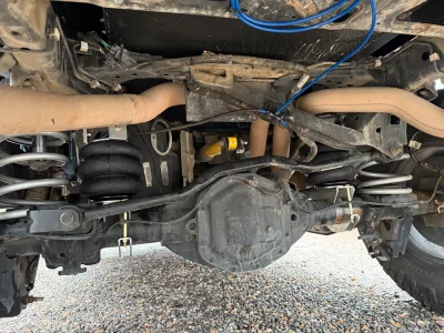

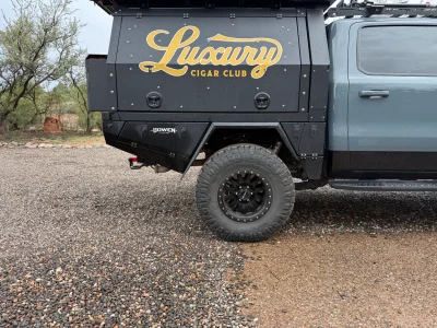

I went back and read your comment on the bags, and I’m glad I did. Orderded this set thanks for looking out. My issues are solved .
looking good now! How they ride? Are you gunna keep ur spacers plates in there?
They feel about the same as the he springs with 8000000000 pounds on them. Yes keeping spacers, for now, have not found a reason to remove
