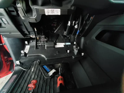

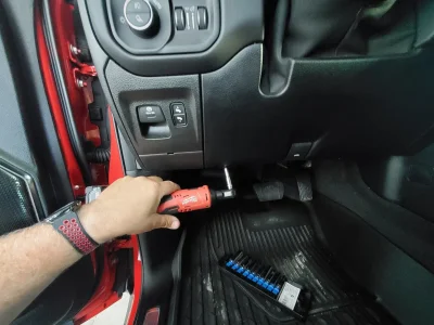

I would highly recommend that every owner of a TRX take a few minutes and check their fuses.
I found at least 1/2 were not properly seated.
Just remove 2 screws and remove access cover from under steering wheel, the fuse block will be in view.
Push on each fuse one at at time... you will be amazed on how many are not seated.
10 minute job tops...but it will save you a lot of headaches down the road!
