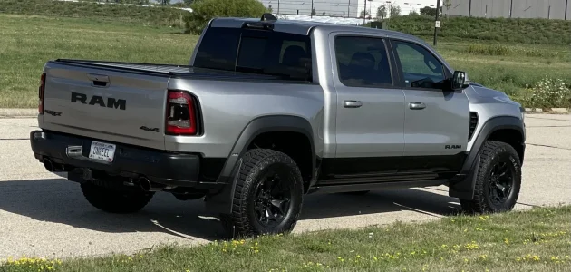

Well, I’m at the 1 year mark with my lovely 2021 TRX Level 2.
Just under 8000 miles. It uses no oil, no coolant, no leaks. Lifetime fuel economy has crept up to 9.9 MPG according to the lie-o-meter. In the winter it was pegged between 7 and 8. So she hasn’t lived an easy life by any stretch with the majority of time spent in sport mode.
There has been no warranty work needed, but I have fixed a few things myself. First, the minor fit and finish things such as exhaust tip and hood alignment. Also, my ambient lighting wasn’t working from day one, traced and repaired a pinched wire on the rear door panel. I did have to take it in to have the VVT harness under the blower replaced, but that was the fault of a tree-rat chewing the wire, not the truck. Everything has been pretty much perfect and I’ve had a blast doing my small, subtle improvements over the past year.
View attachment 49110View attachment 49111
Just under 8000 miles. It uses no oil, no coolant, no clunk, and no leaks. Lifetime fuel economy has crept up to 9.9 MPG according to the lie-o-meter. In the winter it was pegged between 7 and 8. So she hasn’t lived an easy life by any stretch with the majority of time spent in sport mode.
