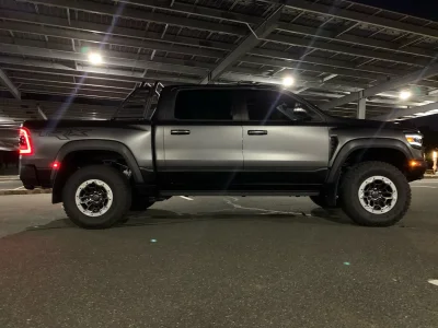

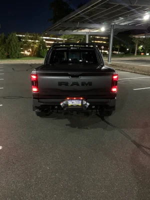

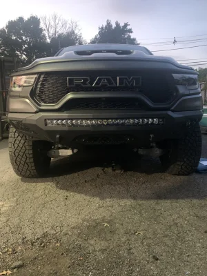

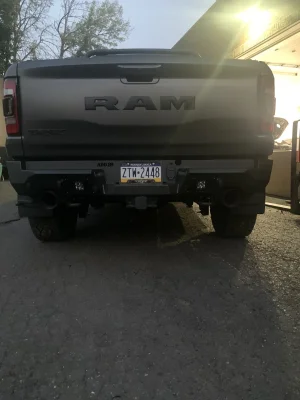

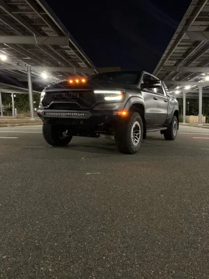

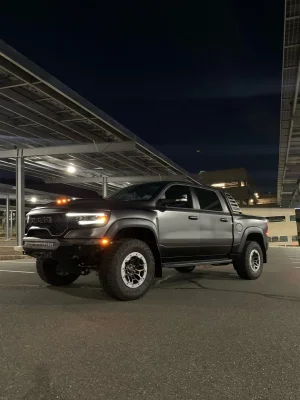

Just got her back from Ripatuned and Peotter's Auto Spa.
Ripatuned twin turbo package. Addictive Desert Design front and rear bumpers. Retrax PowerTraxOne MX tonneau.
Full Expel Stealth wrap.
She's a sleeper until you hammer down your right foot. Loud and incredibly fast.

I'm told 950 at the crank on 93 pump gas. Can tune for E85 or race fuel for more insane hp.

Thanks for the kind words.
A similar TRX on E85 ran 10.8 sec 125mph and 10.6 sec 127 mph at the track. Stock tires and wheels. Steve Rippa posts real stats on his Instagram pages.
You can seriously feel the difference. Feels more planted too for some reason.
Nah. Sleeper street vehicle. Have a HellCat RedEye for that ;)
