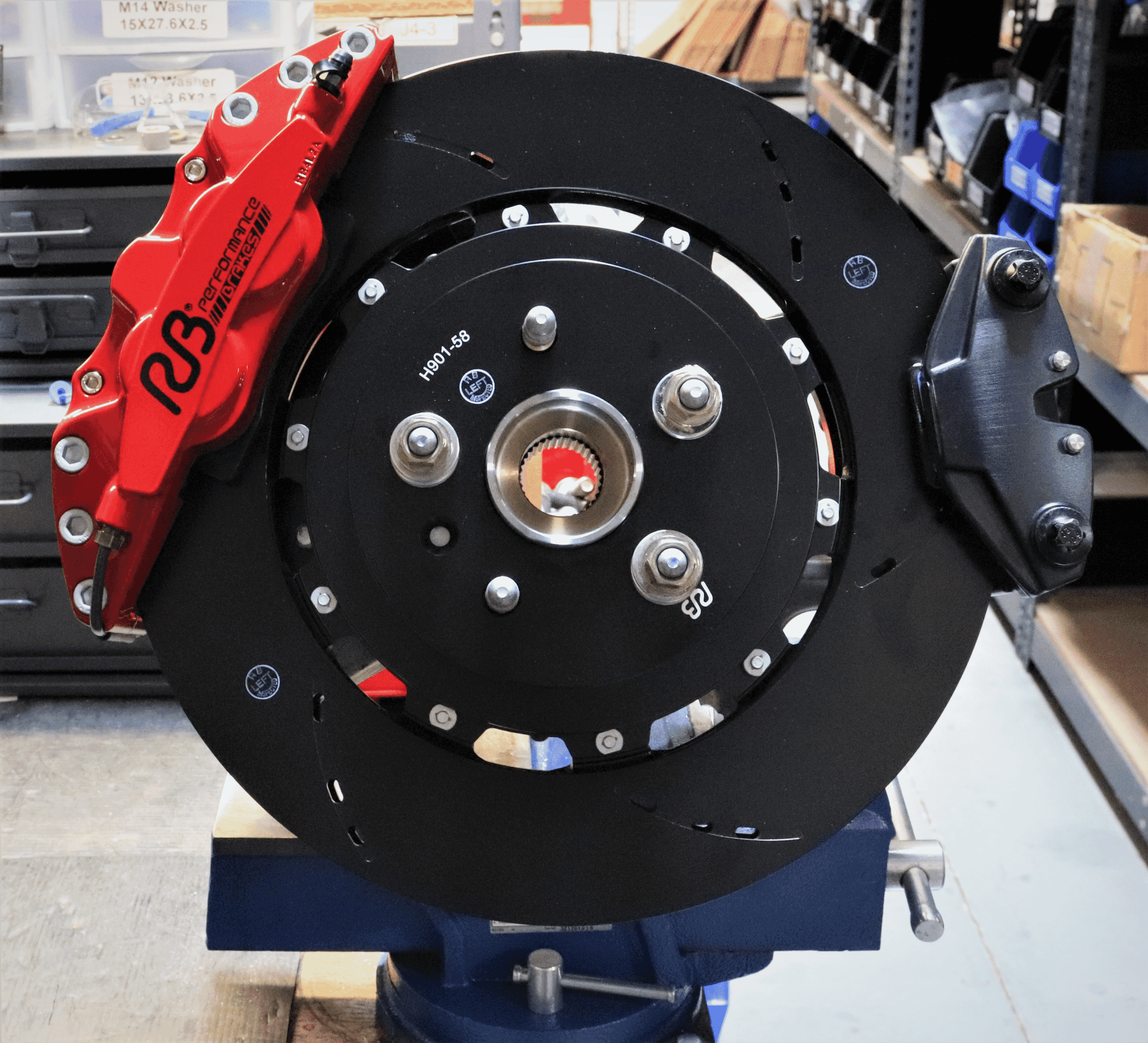

Two separate (main & parking) brakes like for OE Mustang GT500 or Corvette C8 Rear that comes as standard.
Pic shown is a rear CCB BBK for Corvette C8 (OE rear ePB on the right is retained.)

We will deal only the proven and legitimated system (ie. OE setup with a retrofit design).
With this conversion as an example, a 3rd caliper for parking will be added by connecting it to the existing servo motor cable, and the hydraulic hose be connected to a fixed caliper for regular braking in other words the existing single caliper is branched to 2 calipers.
By doing so the original braking integrity is retained.
Due to the retrofitting requires an extra space for caliper adaptors, therefore stock size kit is NOT possible, usually a 2" oversize (20"+ wheels) can be considered.
There are some aftermarket rear BBK which is up to user's acceptance but it's outside our discussion scope here.
Rear fixed piston caliper w/integrated ePB for TRX is at work - This is a new brake development project we are undertaking along with Raptor R and Tundra 2021+
Estimated weight saving over OE cast iron caliper would be approx. 4-5 lbs each.
