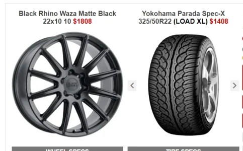

I'd be interested in seeing your setup. I was looking for a higher speed tire as well and figured would have to go to a low profile tire.
Something like this is what I have in mind, the tire is almost identical in every dimension to stock and is a 149 mph speed rated LT tire with a simple blacked out wheel to keep with the theme of the silver and black truck
I ran those on my SRT10 Ram and they did well. IMO the truck may look out of place running 22” wheels.
I appreciate the research help. my issue is here in Texas with speed limits of 85 (so most go 90-95) If I’m passing someone I usuallyjump up in the triple digits for extended periods of time, same thing driving between San Antonio and El Paso. If you didn’t do 110 it would take forever.
combine a 99mph speed rating with 100* heat and blistering sun= recipe for disaster.
I’d be happy with an H Speed rated tire in a 37x13.50R18 even in an all terrain pattern. I know the limitations of that tread design building heat is the main issue but hope these special compound TRX OEM tires start opening up the market.

I agree the truck looks much better on 17s or 18s but at some point you have to accept function over fashion....I will hope with you that tire companies come out with something besides the OEM but i doubt you are going to get any options on 18s that are a bigger OD than the stock 34.6 with a speed rating over an S of 112 but that might just be the pessimist in me
