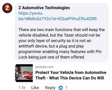

As said above, it’s not a security device. Please do NOT purchase it for that purpose. Get an IGLA and protect your purchase!

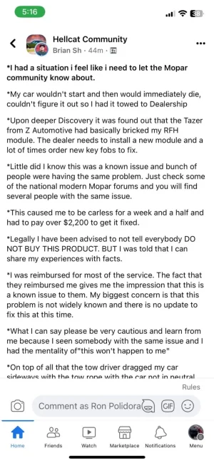

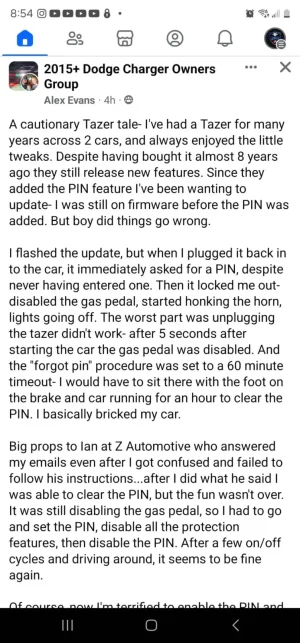

Question for Tazer DT folks.... I believe my RF Hub is down, truck won't recognize key fobs. Battery in truck is good, key fob batteries are good. I was using the PIN lock feature on the Tazer, with the disable throttle and apply ABS features enabled. Since I can't get past the start screen (because key fob isn't recognized, and pushing it physically into start button doesn't do anything) how can I get the vehicle towed? ABS is obviously locked, at least I think it is, because I can't get any movement out of the pedal. Even if I pull the neutral strap the brakes will still be applied. Any thoughts?

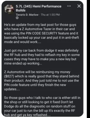

The tazer fries another rf hub…. This is actually very common and if you butter up Ol’ Joe Zizzadoro he might cover some of the cost of fixing it but… don’t hold your breath. He has paid out who knows how much from it doing the same thing to countless people. The tazer when the ignition was on applied the brakes through abs and locked the pressure in it but is only good with ignition on. The rear brakes are also applied but if you have no working fob you would need one or get a 12v battery and disconnect the rear parking brake connector and apply positive and negative to release the stepper motor in it. You will then be able to move it. Then its off to the dealership to probably get a new backordered rf hub and key fobs reprogrammed in. Get real anti theft please…
Yeah, I proactively ordered and received a new RF Hub from Mopar. Will the dealership actually put it in and get me new keys, I'm sure that's going to be a joy to deal with. Thanks for the advice on the rear breaks, didn't think about using another battery... will give it a try. You can bet the Tazer's not going back in.
The rear brakes are a reverse polarity motor, positive on one terminal and negative on the other is close, swap them to open. The key fobs you currently have can be reused, new 23/24 might have an issue though. To program the new rf hub they have to request the needed pin ect and its only good for 30 minutes on new models. Older ones you can do with alfaobd lol
Thanks, good info!
Know any other tricks to get the park brake to release?
From the reading I've done you can activate the park brake without a key fob, but can't turn it off unless you can get the truck into Acc/Run. Huge pain in the ass. Just asked my two truck driver if he has wheel dolly's that'll fit 37" tires... just waiting for him to respond that he can't two my truck.
Thanks, good info!
Yes, a 12-14v battery and a set of wires or a powerprobe
