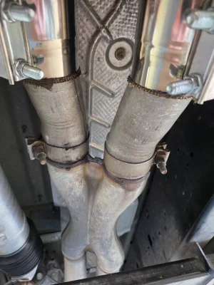

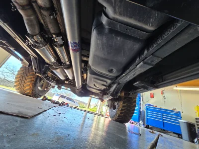

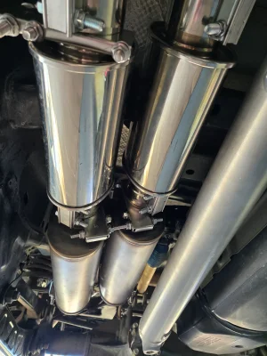

I liked your Jekyl and Hyde exhaust approach. It inspired me to drag out my sawzall and go to work. I was able to do everything without having to weld. I am very pleased with the low rumble note and eliminated the cold start popping that was causing some 5am neighborhood issues.
I have 3 sets of cutouts that have failed to last any reasonable amount of time before failing to seal closed. My DMH set died after 5 month. My 2 sets of Granatelli's lasted even less time before starting that annoying butterfly rattle. I rebuilt both brands multiple times, but they still started leaking again. I just ordered a gate style to see if the sliding gate type will stay sealed any longer than the butterfly style.
Working on a solution for leaking cutouts with a buddy of mine. Once we get the provisional patent submitted I’ll bring some more details to the forum.
