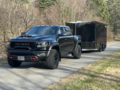

Hello, is there anything I can do to the rear end to keep it from squatting when it’s hooked up to a trailer? It only squats slightly… airbags? Can I not mess with the suspension?

Two full size motorcycles and maybe a tool chest in the front I assume that’s about 500 pounds, but the bike stay over the wheels and like I mentioned, it doesn’t squat too much but I didn’t have the toolbox in at that point. I assume it’s gonna quite a bit more.

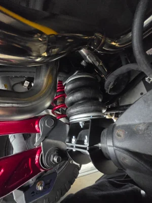

Airbags will do the trick. Just and FYI, if you have an aftermarket exhaust system like mine the bags might not fit. They often change the stock exhaust pathing maybe to improve airflow. I had to cut and reweld my system to clear the bags on the passanger side. Nothing to worry about if you're running stock exhaust

Step one is the best low distributing hitch you can afford. For my research and having towed with it for a few years, weigh safe has been great. It will easily raise the rear end 3 to 6 inches from the height of using a regular hitch. But it’s not enough to completely eliminate squat, that is depending how big a trailer you’re pulling. I pull a 10,000 pound enclosed trailer with about a 2000 pound tongue weight. Timbergrove airbags will take care of the rest to level it out once it’s hooked up and the hitch is adjusted properly. I don’t like how the truck rides with the airbags when you’re not hauling, but after two years I’ve gotten used to it. They do significantly reduce the suspension travel so no more jumping railroad tracks, etc. But they are removable, with hand tools from lying under the truck, but it is more of a pain in the ass than it seems like it should be.
