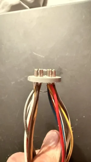

Their 60-seconds-to-bypass just went to 2 seconds... they just invalidated another of their major advertising points: "No master plugs!". Well, now there is... cut the back of the plug off, exposing the two plates, and fill in all the holes with solder (instead of just the select four). Congratulations - you now have a master plug that will start ANY "upgraded" Ravelco installation. <SMGDH>

Wait, a what??? Master plug?? 🤔
