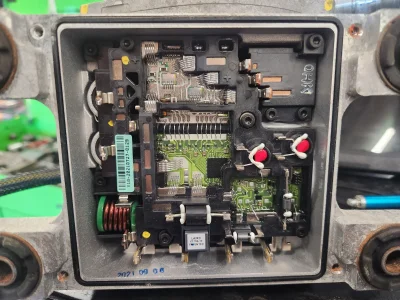

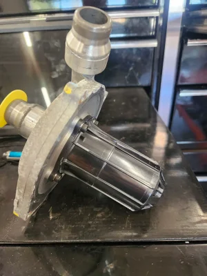

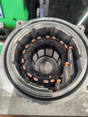

For anyone that's interested what's inside these things I took my old one apart and here you go

Nice! Were you able to find a point of failure anywhere? I got the “I/C coolant level low” warning about a month ago at 40k miles. Luckily topping off the reservoir made it go away after a few days. Now I have an I/C pump on standby for if and when.
No I didn't. It came on twice only for about 5 seconds when it was 35° in the morning. I just didn't want to take any chances and my extended warranty that I bought covered it. It's very weird how it calculates coolant level. Because there is no level sensor. It uses flow and temperature to calculate it
Yeah, that concept is crazy to me. I’m glad yours was covered. Thanks for sharing the pics.
I’m going with that FII 400 when mine fails or when PWR sells an upgraded front mount. Thanks for the pics. That’s a lot of circuit board energy for a pump, yikes.

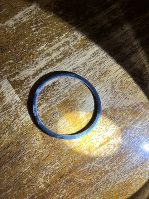

I found the point of failure on mine after disassembly. It is the O-ring that is supposed to prevent coolant from entering the bottom half of the unit. It is between the pump portion and the black plastic housing. Coolant entered the electronics and caused the failure. The O-ring is of very poor quality and had metallic particles embedded in it.
I'll have to pull mine down further and look
Wow, thanks for sharing that info. I spent 13 years as a mechanic so I’m always curious to know the “why”. When I first got the “I/C coolant level low” warning, I checked the fluids and it was just a tiny bit low. I added maybe a half a cup of distilled water to the reservoir, gave it a few days and run cycles and so far the warning hasn’t come back. I couldn’t believe that less than a half cup of water was the problem, especially with something that doesn’t even have a fluid level sensor. I also marked the reservoir fluid level and check it frequently for fluid loss.
