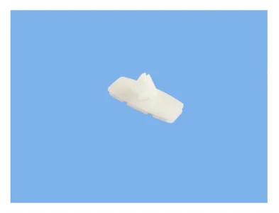

MrUAE
Jun 29, 2021
5
2
16
United Arab Emirates
Ram 1500 TRX
Looks like these white things circled in red are what hold it in place, maybe? This is the side I'll be replacing.
New molding only has the guide tabs.
The parts diagram doesn't show those white pop pieces unless they look different in the diagram.
If they aren't reusable from the old one does anyone know the part number?
Thanks,
Part number 68526185AA
part name W clip

So I figured I'd update this thread. I got the trim piece back from the detailer after having it coated to match the rest. A few things I figured I'd point out. Someone linked the clip pieces earlier in this thread. They are not the correct pieces.
Factory clip on the left is gray. The part number on the bag is the white one. I made them work by cutting the white clips shorter. The white fastener that clips into the hole on the fender is slightly larger than the grey one. It works but I'm going to try and find the correct ones incase I have to swap them again.
