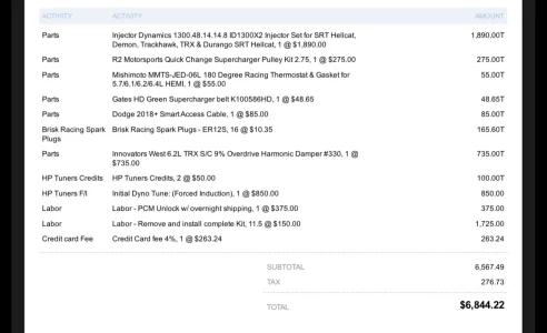

Referencing our other conversation thread @AZDinoPwr. Thoughts on this package? See attached. Will be in San Antonio. Should I add or remove anything to this set up to increase reliability? Again, I’m thinking of a conservative tune but would like to get on it a few times a week.

Assuming this is a dedicated e85 build? If so, I would ditch the plugs and do an intake.
JMS performance if I go with their kit.
I'm also looking at FAS motorsports and would use JMS to install but i’d use FAS for remote tuning.
SAN Antonio - 650’ above sea level

JMS Racing is the shop that “scuba Steve” here on the forum used for his tuning/install and it was a joke. Actually probably the biggest joke of this forum since it was created. Got to the point that I messaged the shop to talk to them and they admitted their dyno isn’t accurate at all and that they remote tune on that dyno (don’t use their in house staff). There’s an entire thread on that on this forum including the screenshots from JMS. They are clueless. That set of parts for the package reaffirms that idea. Plugs are a waste and pushing well over 15 lbs on 93 octane is unwise. I would be genuinely surprised if they had any tuner that does flex tuning on MOPAR. I would ask them how they setup flex, inferred or sensor?
To my knowledge still only 4 tuners in the country that do flex tunes on hellcats. Barth, Satera, NicD and Dusterhoff.
If you really want JMS to turn the wrench then go for it but have Curt do the remote tuning then and get a good flex tune from him.
