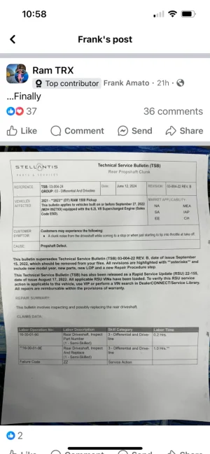

I saw this on Facebook last week and nothing has been posted here. It looks like they will replace your driveshaft if your TRX was manufactured prior to Sept. 27 2022 or if your vehicle exhibits symptoms of the clunk.
Is this a new revised driveshaft or is is the same replacement they have been using all along?

I think there's a few people on here that have had the driveshaft replaced under warranty and have mentioned the clunk came back. I had the boot and grease "fix" done over a year ago and my clunk came back in May. There's an aftermarket driveshaft thst apparently fixes the clunk permanently but it hasn't been out long so I'm waiting for some long term feedback from some members here who have it before I jump to buying one.

I had the driveshaft replaced a while back and the clunk came back. About a year ago I had the fancy lube job done, and the clunk is just starting to come back.
For me it’s all about documentation. If there is an updated driveshaft that they will replace under warranty (or this TSB) I’ll do it just do document the issue and cover myself from future problems.
Is there a Ram TSB website where we can actually print a copy of this off versus a Facebook screen shot?

Mine has 42K on it so I'm hoping they will warranty it. Service Clunk has been going on for years now. I've had the grease kit installed twice now. Only last a few months and it comes back. Called dealer and have an apt Friday for them to look at part # and hear clunk to order driveshaft. 🤞
I have a new in box grease kit I was going to install before I seen this. Worst case I can use it if it comes back like I hear it can.

I was able to get mine replaced under warranty at 30k miles after getting it greased previously(lasted about 200 miles). Hoping the new one lasts longer because that is super annoying!

Was the replacement a new part a revised part number, or the same as original?

I have an early 2022- I had the grease fix which lasted a few weeks, then a new driveshaft ending in AE (sometime last year) which lasted a few weeks, then the grease fix again about 4 or 5 months ago which lasted a few weeks, all under warranty.
This is a BRAND NEW TSB that just came out a few weeks ago with a new shaft ending in AF so I'm cautiously optimistic. I've already got an appt on the books once it comes in to have it replaced. Will it fix it for good? I doubt it, but if Ram is going to keep trying to fix it for me for free, I'm going to let them. I'll reply back once I get it on and I've went a solid month or so with no clunk 🤞. Longest fix for me has been about 2 weeks so anything longer than that here may get my spirits lifted...

The answer depends on whether driveshaft #53011135AF has any real improvements over # 53011135AE. Seems like there is a chance as the TSB overrides the previous "re-grease and send on your way" ....
