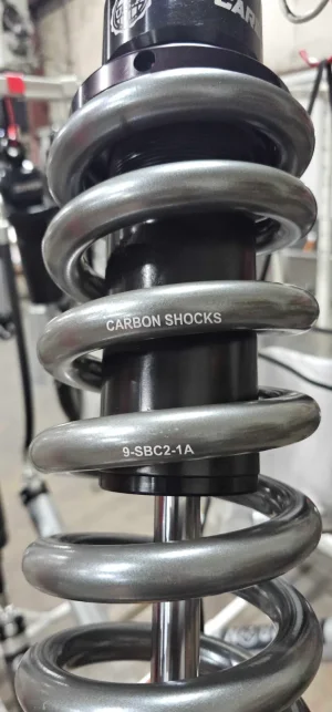

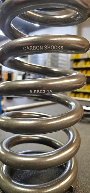

The TRX is a unique platform. It’s not light… but it’s not obese.
The unique to the trx and different than the ram 1500 rebel shock bucket and the oem lca geometry and motion ratios…. Combined with the speed the truck can generate….
Requires unique spring rates up front.
What is commercially available from the industry standards are limited at 700lbs.
Factory is 1050 to 1100 depending on part number and like most oems is over sprung.
But 700 is too light and you are forced to add too much comp tuning and nitro pressure and your rebound is… well I’m not a shock tuner.
One of the big delays for the carbon trx shock release was springs. We wanted an ideal package using made in the USA parts.
So lots of testing. And we needed a stiffer spring. I’m not going to let the cat out of the bag on rate.
But the springs are made in the USA for carbon to carbon specs. Including an Easter egg part number.
But, I like details and behind the scenes stuff. The production run of springs came in a few days ago and assembly has started and shipping is doing their thing.
But I want to show some pics and I may get yelled at by the owner of the company. Or he may come here and release all the secrets …
Custom springs specific for the trx and RHO… not just using what’s available on the shelf.

Tuning proper spring frequency to the natural oscillation of the vehicle.
Proof is in the performance and so far all who installed have said OMG they cannot believe how good they do and how much they love their truck again.
