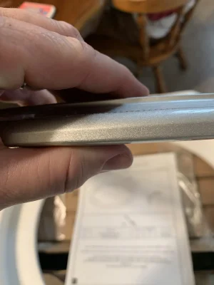

Well I have 12 bolts and my tire lip is in the beauty ring. With that being said can I just take the ring off with the weight of the truck still on the ground , also do I need to let thes
air out.
Wait what? Take a picture and post it.
You’re tire should not be sandwhiched in the Beauty ring
air out.
So the tire is mounted between the Beauty ring and the wheel and not like these pictures
Well I have 12 bolts and my tire lip is in the beauty ring. With that being said can I just take the ring off with the weight of the truck still on the ground , also do I need to let the air out.
It can be hard to see the actual wheel behind the ring, but if you look close at Fifty's 2nd pic, you can see the double wall... wheel rim and beauty ring. The tire is definitely behind the wheel.
I can't really see it either way in your pic, due to the angle. HOWEVER - if you really think the tire was mounted on the OUTSIDE of the wheel, meaning someone mounted the tire AS IF the beauty ring was a true bead lock:
1 - I don't know how the hell that's holding air
2 - Do NOT remove the beauty ring without raising the tire off the ground and deflating it first.
BTW - I love your floor!
New pict.
Yep.
Those are the beauty rings. And the tires are mounted correctly for the beauty ring.
The beadlock ring is a 24 bolt ring and a part you need to buy
