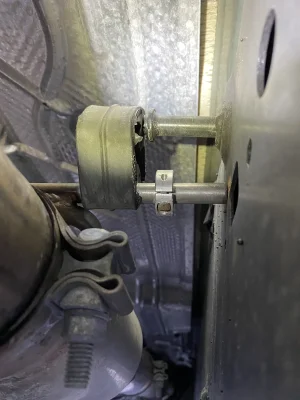

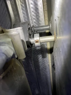

Has anyone had an issue with an AWE exhaust install? I had heard that you have to extend the suspension to install the exhaust correctly, so I took it to a shop. I had the system installed by a reputable shop and after the install we found that the H-Pipe hanger is touching the chassis. AWE told me that the shop didn't know what they were doing so I took it to a Dodge SRT dealer which works in almost all the TRX's in the area and they told me the same thing...we can't do anything, and the exhaust just doesn't fit. Called AWE and they wanted me to take it to another shop. So I went to a custom muffler and exhaust shop that ONLY does custom exhaust. They make exhaust systems in house and know everything about fitment etc. I was told that they system didn't fit well and that its touching the chassis. I called AWE and they told me they would work with me and that the RD side will examine the photos I sent. Well, y'all take a look and tell me what you think. I'm asking for a new H-pipe when honestly, I think the company should give me a refund or fix the issue asap. I don't like how this exhaust is sitting against against my frame, for over $2k this damn exhaust should be perfect.

Thats a bummer. Looks like hanger is just too long? If you just cut an inch or two off would that fix it or does somethimg else not line up?
We talked about shortening the hanger but the issue is that the H-pipe is angled improperly and that the right tip is sitting an inch lower than the driver side. It's clearly an issue with the weld but I would have to remove it and send it back to AWE before they would identify and fix the issue. The hanger is solid stainless steel so cutting it wouldn't be easy but if I get stuck with the exhaust came to the conclusion that I'm just going to have a custom H-pipe made.

Watch this video. Did your installer loosen the cats prior to installing the H pipe?
Thanks Rob, that’s even better. I was trying to show OP what @JC posted:
Finished the install of my AWE 0fg exhaust. Make a note, unless you're a very lucky person, you'll really want to loosen the CAT to exhaust manifold ball flange before trying to get everything aligned otherwise the 1st passenger side pipe that attaches to the CAT will most likely push the 180 tech can into the passenger side frame rail. It will take some adjustment/twisting of that CAT ball flange to make room for those big 180 anti-drone cans.
Yep, that was my exact issue. I got assistance from @Josh/AWE via PM who advised me to loosen the CAT ball flange. Now it fits perfectly, also note the factory nuts on the ball flange are only 24 ft-lbs so don't over torque and snap them when you're tightening them back up. I also only needed to loosen and rotate the passenger side but if it's still not moving enough you might need to loosen both sides.
AWE needs to put a full step about the CAT in big bold letters in the instructions instead of just a little note.
